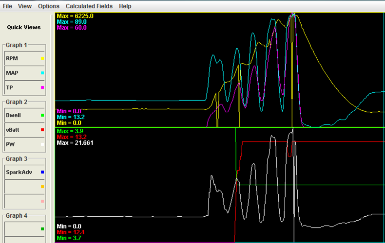

It works fine with Trig. Offset = -30° (before -301.5) and Delay Teeth = 30 (before 0) ...No more dwell shrink. See attachements.
My next problem is the tach loss you can see on data logging. I will try to fix it by myself with the forum database.
Thanks one more time for your quick and precise answer.
Patrick

I see 1 tach loss when you get over 6000 rpm - is the loss consistent at high rpm or can it happen any time. We normally see this with a missing tooth wheel, but you don't have that. I also see a very sudden dip in the battery voltage just before the tach loss. You might need an audio cap across your battery if that happens whenever you lose tach.

Thanks for you analysis, i plan to buy a 2F audio capa in the next day to finalize my installation.
But, i think i fixed my issue. I had tach loss at always fixed rpm mostly at 1700, 3400rpm. Signal measurement with oscilloscope shows me that the crank sensor has the bad polarity. The logic output time of my LM1815 (around 0.3 ms) was added in the calculation. When the time between 2 teeth was in the same order or a multiplier of the logic output time, 131 teeth instead of 130 was seen between two reference inputs. Since i change from falling to rising, i have no experience tach loss anymore. Hope my analysis is right.
Patrick
