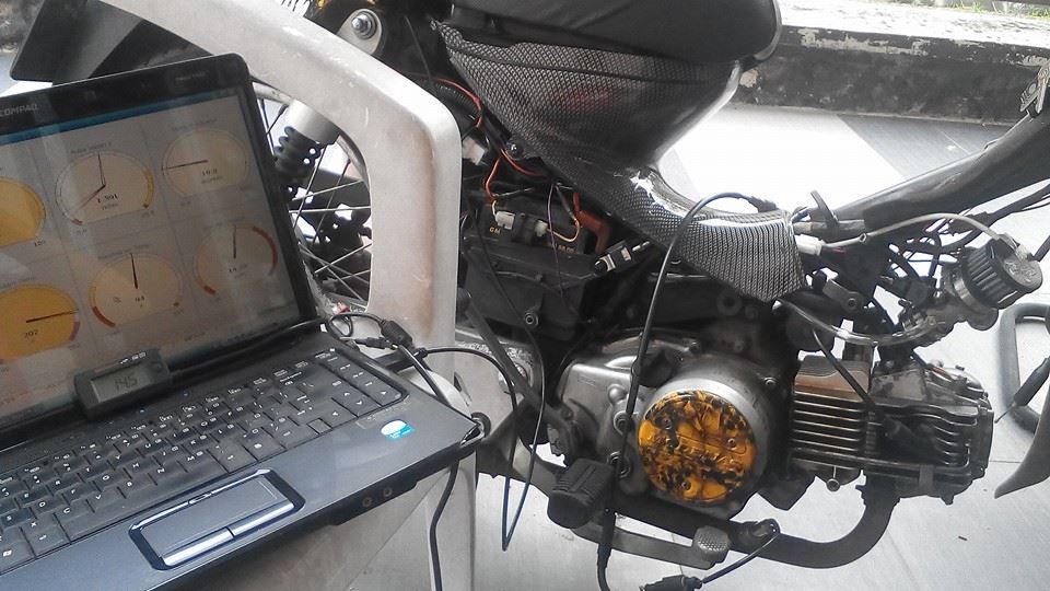

I am using Microsquirt V2.88 on Modenas Kriss 110cc 4 stroke, same engine with Kawasaki KSR 110cc
I had off all the additional features such as acceleration enrichment, EGO, etc. Just wanna tune the basic VE table.
Tried to use the VE table generator, but my engine displacement is too small for that function.
The engine can start easily, but when WOT, it stumble.
Any body can help me with req fuel & VE table?

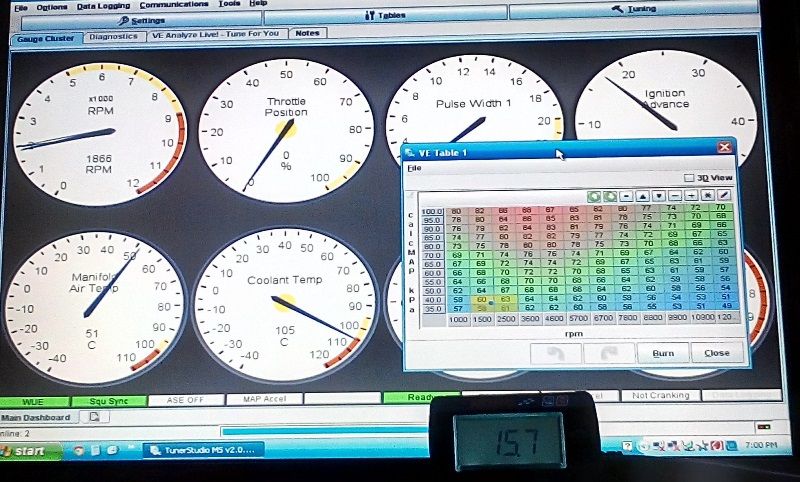

Thanks, I had tried it, and it works.
Now need to fine tune the VE tables and other function
