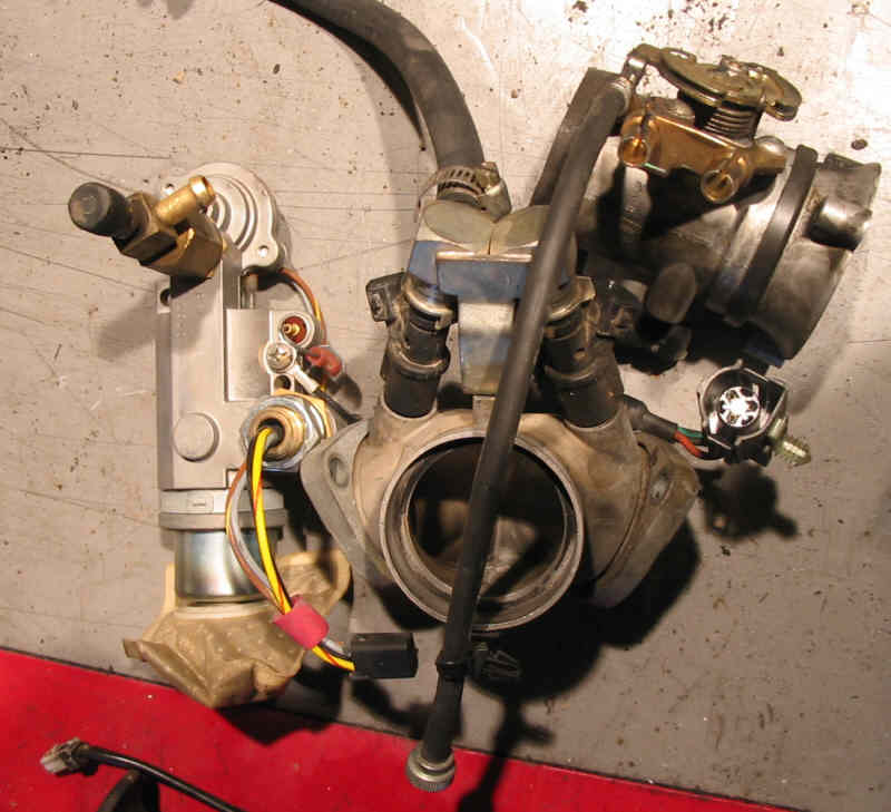

MS'ing 45 degree V-Twin
Skiericski
- Helpful Squirter
- Posts: 35
- Joined: Mon May 24, 2004 1:17 pm
- Location: UT, Logan
- Contact:
- Attachments
- (52.29 KiB) Downloaded 43 times
