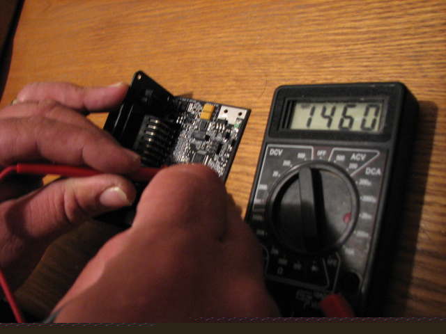

I tested R20 and got a couple of values on the >+ setting the value was 1460 ohms, and the 20K setting was 2.32 so 2320? heres some pics any ideas? could I go to rad shack and get a new resistor of the value 680 ohm @1/4watt and replace?
Re: odd problem need some help
It is a bit tricky, but I have soldered a through hole resistor in place of R20 before.

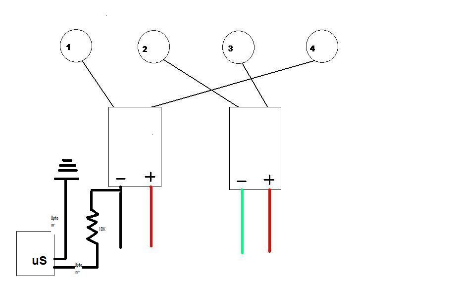

just for future reference heres the circut Ive been using to trigger uS. This worked until the resistor broke and I tried to run without it to get home. so it looks like the opto circut (R20) can be damaged with out a resistor.
(26.98 KiB) Downloaded 6 times
Some coils can damage it; when hooked to a sensor instead, it's not at risk.

Post by A2TURBO »
Bruce I tried the setup you suggested (Optoin+ to neg coil and Optoin- to +bat through a 4.7K resistor) and the unit suffered serious rests and was undrivable so far the best setup is my original Optoin+ to neg coil through a 10K resistor and Optoin- to chassis ground. it still has occasional resets but they usually donteven activate wue or ase. is there another setup you would like me to try? Im currently using my original setup and continuing with the tunning process (I got a good table it just a little to rich on top)
