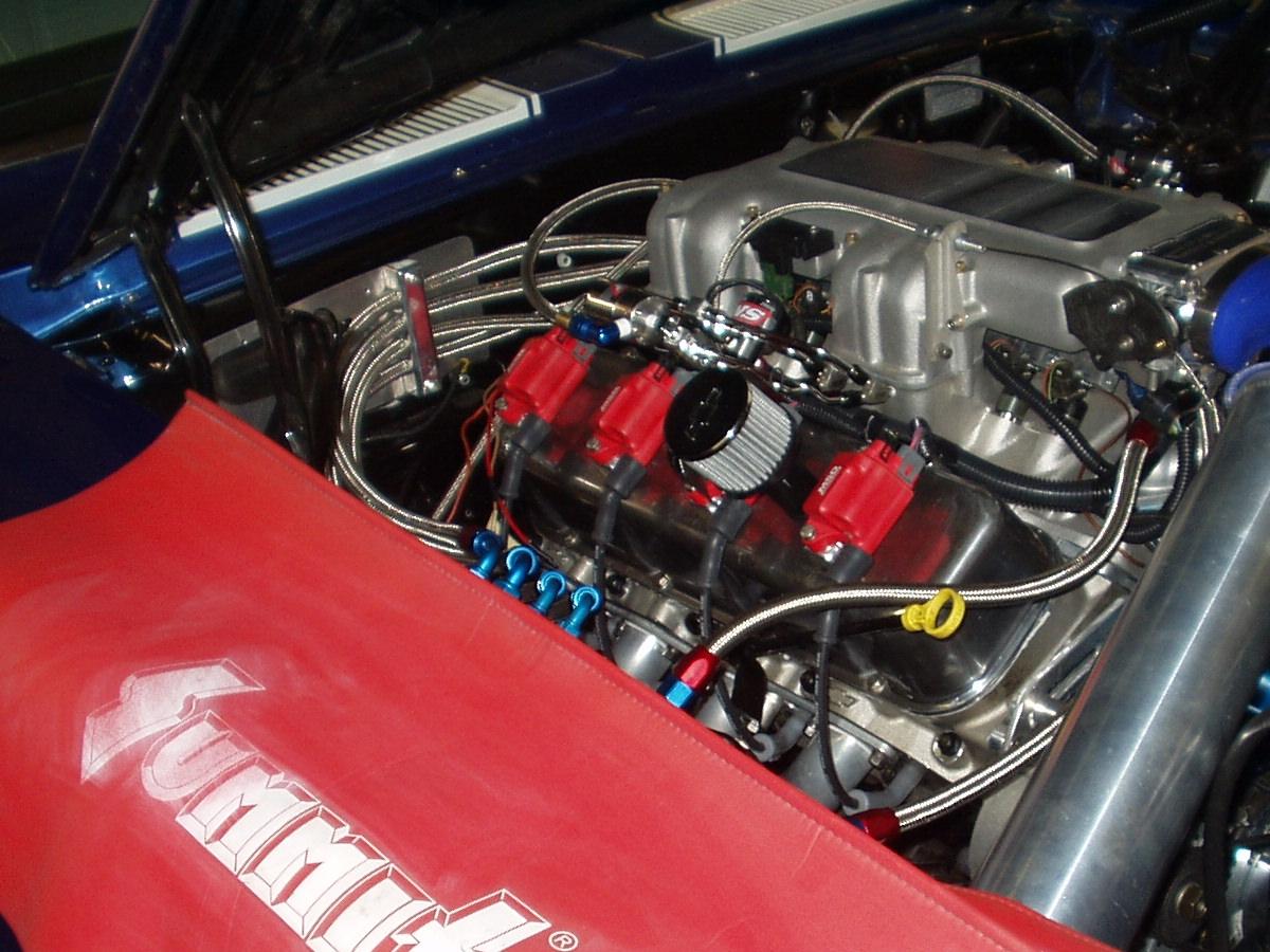

This is the setup I'm using (Had trouble with attachent on other post)
Joe
(153.15 KiB) Not downloaded yet

Good info Joe. Very nice looking setup.
