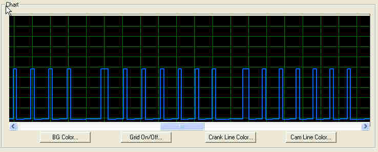

I'm finally up and running on this project again..the FZR1000 crank with the large slot. I ran the TachRef program and got the plot below. Can I use these for a crank tach signal and combine it with a cam signal?
My next step is to get some BNC adaptors and scope the crank/cam and ignition outputs, but if this doesn't look OK.
I am going to switch cranks in my rig for a 4 crank teeth +1 cam tooth set up, get that working and then try and mod the teeth values for the "8" toothed crank later(with a cam tooth pick up too). I have got stable cranking revs etc, no loss of tach, etc on a datalog, but when I drive an LED to pretend to be a coil the output is intermittent and not regular except at higher cranking speeds.
Any thoughts ?
These are the crank pulses the TachRef program displays using a YZF1000 or FZR1000 crank.
Re: So, how many teeth do I really need?
If you put a piece of paper over the plot and mark off the rising edges, you will see that all the marks are about the same distance apart, so as far as the processor is concerned (which only detects the rising edges) there is no missing tooth. If you set it up for falling edges, things look better, not perfect, but it might work. Then just set the cam sync so its detection edge falls approx. in the middle of the missing tooth.

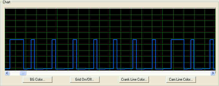

Thanks for the advice, re wheel selection, but it seems I don't need the cam sync, if I mod the crank...here's the crank pulses before

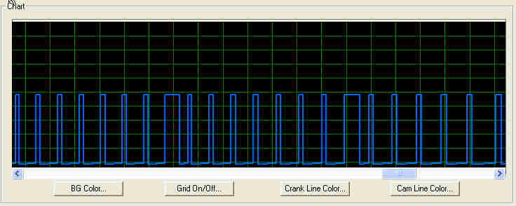

and after adding metal to the crank slot
so you can see I have a missing tooth now, that'll let me reference a sync to, unless you know otherwise.
PS By altering the Pulse Tolerances, I can now get the ignition and injection outputs to flash the LEDs and start working at just 60rpm on the rig, whereas before it was nearer 100+. I don't know if this is expected, but it seems pretty slow turning to me for an 8-1 wheel to start working. 8)
