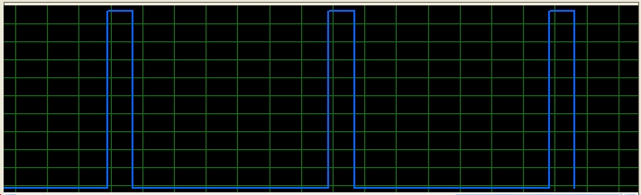

I can see the processed pulses using the TachRef.exe program when I piggyback the VR signals off an idling engine running off the original ECU...and occasionally I can see cam and crank sensor square waves on the same screen (blue and yellow plot above), but most times I only see the crank plot, although the cam sensor is working.
I have wired the cam sensor into the crank VR1 inputs and I see a nice regular plot, yet it doesn't show on the VR2 plot. I have tried switching polarity and there is no difference in behaviour, other than the crank plot "inverts".

Several things. In your tachref plot, what counts is the spacing between the EDGEs being close to the same. For example, if you measure the distances of the crank teeth edges, then if you choose falling edge, the wide tooth won't hurt anything, but if you choose rising edge it will.
In dual spark the masks have no effect. The pulse tolerances can not be set to 0 - that asking that everything be absolutely perfect. Leave them as the defaults until you get to the stage where yopu are just getting minor misses.
A 4 tooth wheel should work, but it gives horrible accuracy. It is fine with a distributor, because the dizzy takes care of the fine timing. I would want something with at least 12 teeth.

Hi again, another day, and the falling edges for the "ignition capture" did mean I got RPMs seen from 700 onwards briefly, before being stable at 1300 or so, but bear in mind the engine is idling at 1000 rpm or thereabouts, so this first figure must be the gauge catching up. :) It now only skips a ±trigger evry now and again at 4000 rpm 8)
I still can't see cranking RPM, with pulse tolerances at default, and under investigation using TachRef.exe, on a running engine I don't seem to get a cam sensor plot. After what Al posted about seeing edges, I can only assume the Microsquirt can't see any on the VR2 input. To double check this, I cranked the engine with the cam sensor VR2 unplugged and there was no difference, slight bit of false instantaneous edging on the crank VR1 plot, but the falling edges look OK. I again assume that these instantaneous edges the thickness of a line would be covered in the pulse tolerance settings, so they are ignored?
I know I have a good quality VR signal, as I have seen it on my USB oscilloscope, and it has a steep climb, so the Microsquirt should be able to process this info. However, the interesting thing is if I plug the cam sensor VR into the VR1 crank inputs, I get a healthy plot in TachRef straightaway on ceasing cranking (with either polarity). So it looks like I have a faulty VR2 connection/input, because AFAIK the MicroSquirt is not seeing anything on this input...at cranking. It does later, on a running engine going fast idle at 1400 onwards. :? :?
