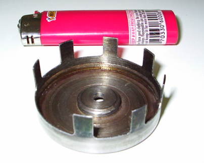

Here's an 8-1 wheel I got made up for the Buell. Hopefully (a big hopefully) it'll bolt straight in to this Harley Sportster-based motor, using the original hall sensor. I need to do some more bench testing first, and finish the fan control cct (this has been a challenge, since it is a 2-speed fan using pwm for half speed, and has different turn on/off temps depending on whether the engine is running or not etc etc) and try to get PalmTune working with MS2 (another big one since I'm not experienced), and then get hold of a uS. When I work out the orientation of the wheel on the camshaft I need to drill it near the center and fit a short rollpin to locate it. So I have plenty to keep me busy for a few weeks or months or so. It's good to see your progress Dr Hess, I hope it all goes together nicely. All good clean fun! :)
Edit - the tooth on the RHS is not bent, I've checked it many times since looking at that pic!
