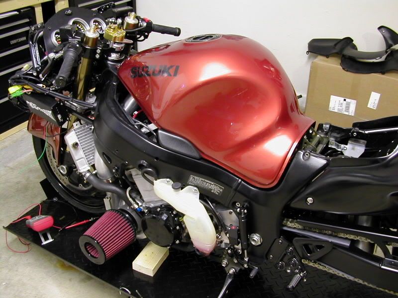

My bike cranked right away and idled. I had lots of help from my father (Ron Dickey). :D
I'm very happy with my MS-2. I've been slowly tuning the bike for a few days now. It idles great and is already making 3.5 psi at 6500. Little by Little.
This ECU seems to be alot more stable than the other I used. I better not say what system that was.
I've learned so much the past couple of days & I think my head is going to explode! Just Kidding! :RTFM:

Very good work. Thos Busa's are amazing. I want to get one, but I'm sure my life would be shortened greatly.
What turbo kit are you running on the bike?
Are you running stagged injection, and what are you doing on the ignition and triggering side of things?

Very interested in how you have done this.
Are you running speed density or Hybrid ?
Don't suppose you want to post your MSQ ?
I was using the Megasquirt just to fire the second set of injectors on my Turbo Busa now I am using it for both. Going to have a go at initial mapping tonight.
If your intereted http://www.bridge-digital.co.uk/turbobuild here is my turbo busa, in a car though :D

Two Wheel Engineering built the bike, including the Turbo kit. Single set of 750cc Injectors. I'm using a MSD MC-4 Motorcycle Ignition. :lol:
Spenser309
Not much of a street bike. It's a Drag Bike. If I can run 300mph in the 1320, than cool! :lol:
bazzer
I'm using the MS-2 as a stand-alone. I will post it, but you will need lots of fuel. It's fat right now. :RTFM:

Microtech LT-10s. They were no help at all. :x
