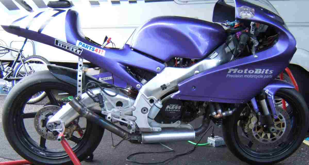

I have enclosed a photo of the finished bike. It is getting some cosmetic work done during the off-season.
"Boris"
KTM engine in Aprilia RS250 frame
(41.45 KiB) Downloaded 27 times
