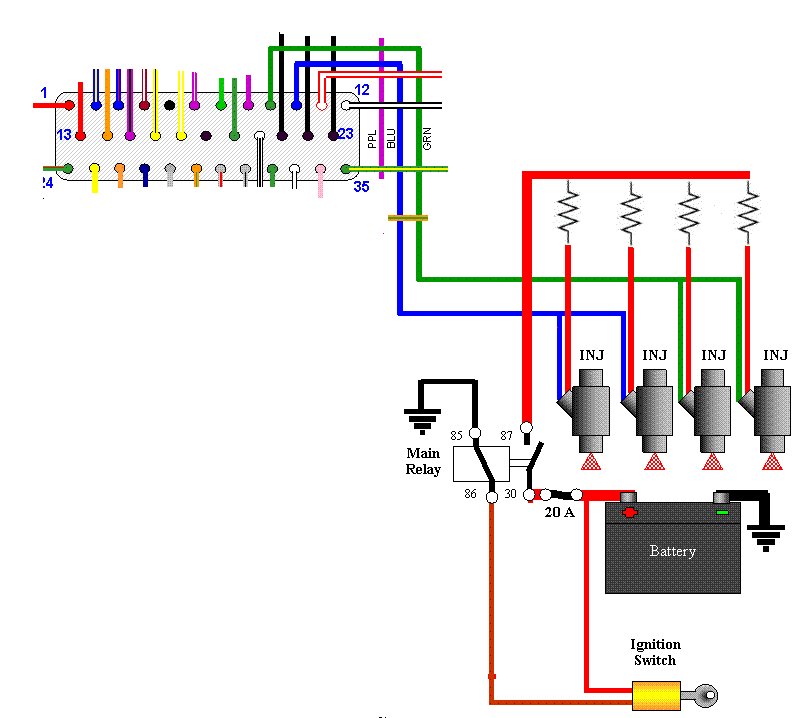

The wiring checked out ok. It’s a 4 cylinder flat four with one side of 2 injectors wired in parallel to each of the INJECTOR9 & INJECTOR10 wires. The +12v from the relay connects to one side of the 4 resistors then onto the other side of each injector.

arr_kid wrote:The wiring checked out ok. It’s a 4 cylinder flat four with one side of 2 injectors wired in parallel to each of the INJECTOR9 & INJECTOR10 wires. The +12v from the relay connects to one side of the 4 resistors then onto the other side of each injector.
Could you draw a diagram of this? That doesn't sound right, but I may just be confused by your description.

No probs, it did sound a bit strange.
(77.62 KiB) Downloaded 26 times
Ok, that clears things up. When you measured the voltages, was that with the injectors plugged in and the Microsquirt powered up but the engine not running?
