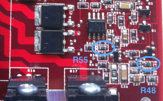

I am going to mod a cased MicroSquirt to lower the offset voltage, but the component markings are "smudged" on my board. Are these R48 & R55?
MicroSquirt board, R48 & R55 locations?
