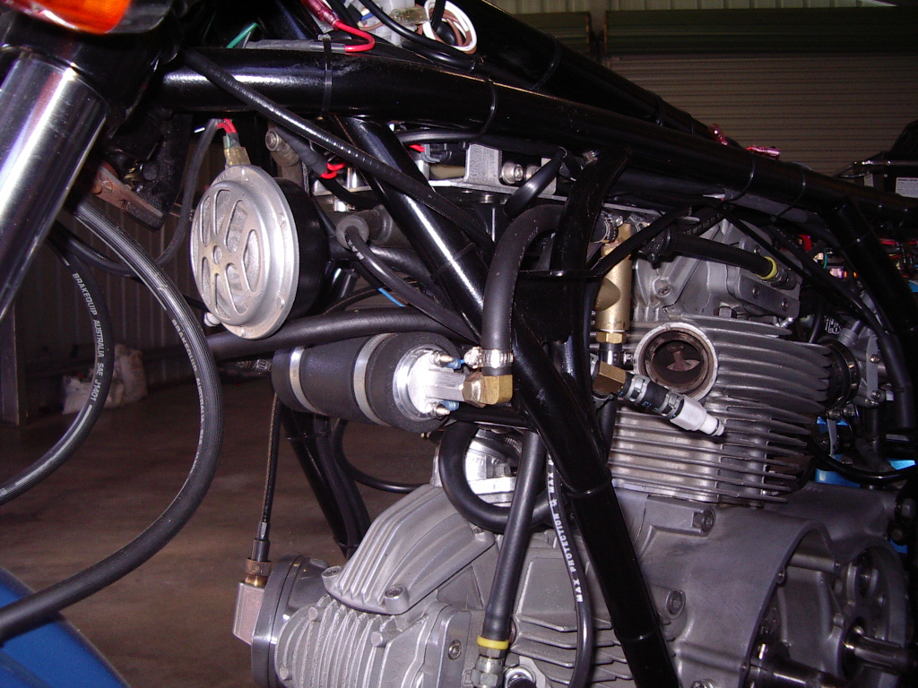

I use a Walbro GSL393 160 LPH inline automotive pump on my bevel drive ducati twin. It is not a physically large unit and I had no problems finding somewhere to mount it. I run it on a PWM power supply which measures 7 volts at the pump. Tests show that at this speed the pump flows approx 45 LPH and easily maintains 43 psi. This system has been in service now for nearly three years now without any problems at all.

Paul_H wrote:I use a Walbro GSL393 160 LPH inline automotive pump on my bevel drive ducati twin. It is not a physically large unit and I had no problems finding somewhere to mount it. I run it on a PWM power supply which measures 7 volts at the pump. Tests show that at this speed the pump flows approx 45 LPH and easily maintains 43 psi. This system has been in service now for nearly three years now without any problems at all.
What do you use for a pressure regulator? What kind of current draw does the pump have and do you have any details on your power supply? I guess maybe I was dreaming thinking I could pick up a pump and regulator for $80 or less?

I use a Magneti Marelli 3 bar pressure regulator which is standard equipment on Ducati 2 valve belt twins using the 45mm throttle bodies. The power for the pump is supplied by a 12VDC motor speed controller which I bought in kit form Jaycar (an Australian electronics retailer). If my memory serves me correctly I think the pump draws around 2 amps at the speed I run it at.
