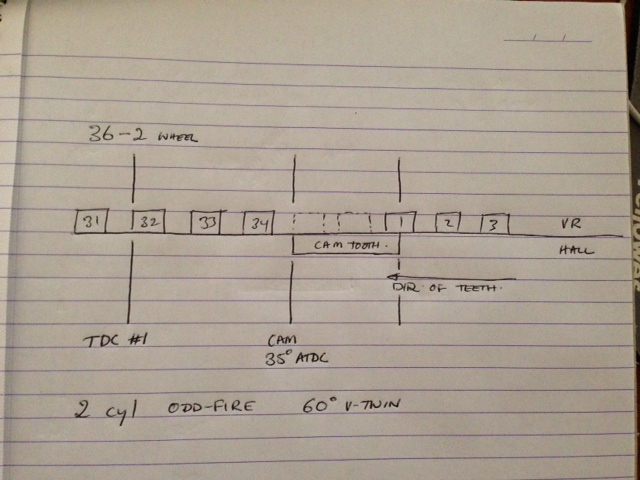

The engine is a 60deg V-twin Aprilia RSV Mille engine. Please see diagram of trigger arrangements , current msq and datalog

dia of tooth layout
dia of tooth layout

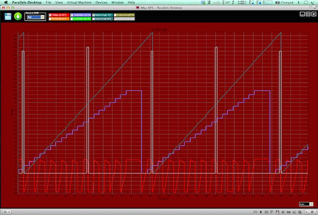

PPS The other day I was using some obscure ignition software and they had this rather nice set up, which gives you all the info you require re triggering!
The red trigger wheel traces are at the bottom, the white columns are the 180º ignition or tach events
