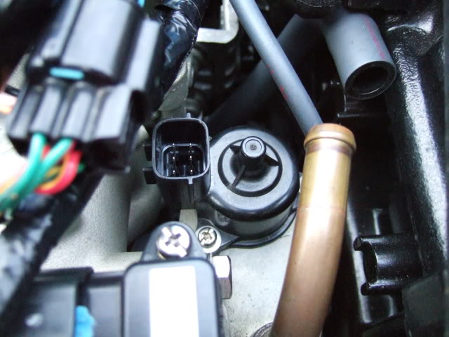

i have a yamaha snowmobile, im going from carbs to fuel injection.
im using the throttle body from a later model sled (straight fit)

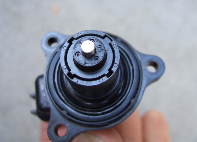

my question is: can microsquirt control this IAC Valve?
Re: IAC valve compability question
If all four pins are connected to wires used by the FIdle valve, then no - that's a stepper motor, and the Microsquirt doesn't have the means to control it.
That said, I have a PWM to stepper controller on its way to a tester. This will allow the uS to control a 4-wire IACV using the FIdle PWM output.
Success! After a few delays and a quick mod to sort out an issue, my tester reports proper operation of the stepper idle valve driven from the PWM idle signal. I have fresh, revised boards enroute incorporating all (minor) changes discussed in the field testing, and complete units should be available in the next few weeks.
