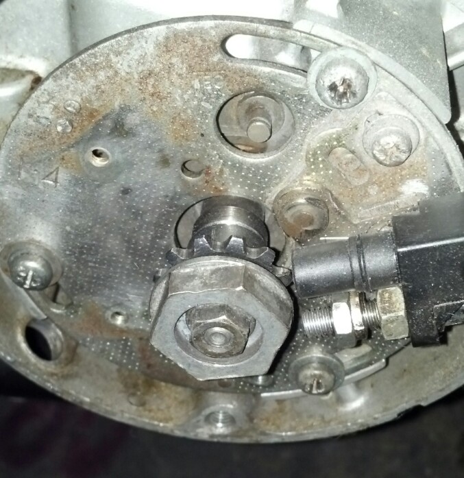

Do you have any pics of the trigger wheel VR arrangement? Can you decrease the air gap, as this will boost low speed RPM detection. The VR circuitry in the v3 should take care of the over voltage at higher RPMS.

i had scoped this setup on the bench and was happy with the pattern and wasnt really paying that close attention to the low speed voltage. i am gonna do some more testing, this is a wheel speed sensor from a chevrolet truck and the teeth match the sensor quite well. i was hoping to make this work because it was free!
and it fit good it the points cover.

Well what i have done is found a 24 tooth wheel and a matching vr sensor from what i think is a mitsubishi automotive distributor. the motorcycle does seem to start better. however still no signal at below 300 rpm. so i have tested the new sensor at kicking speed it puts out .5 volts ac. at 300 rpm it puts out 2.0 volts ac. not sure if thats good or bad? maybe a better way would be a hall sensor? like i said it does seem to start better now! about 1 second in and it has rpm signal and fires up shortly after. i can live with it this way for now and maybe upgrade to a different sensor at a later date.
