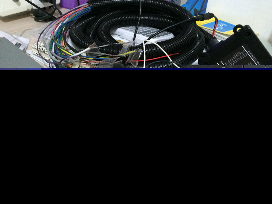

Hi Matt,
I did a flash of MS2 extra 3.3.3, and test mode works normally. The problem is the ignition signal, this work all time (same without rpm). I put a picture to you see, the LED stay alight all the time. I will use a single coil Bosch and a trigger whell 36-1. The engine is a yamaha WR 450. I set the configuration to basic trigger to work speed on stim. I had change some configuration, but doesn't work. I changed the microsquirt and the problem is the same, I have two microquirts... Please give me a sugest rs... Thanks...
(701.38 KiB) Not downloaded yet
Re: Problem with analog signals
Adriano Custódio wrote:I put a picture to you see, the LED stay alight all the time.
What LED?
Adriano Custódio
Posts: 7
Joined: Sun May 31, 2015 2:38 pm
Post by Adriano Custódio »
Ignition LED on stim. I sent a picture for you see....
