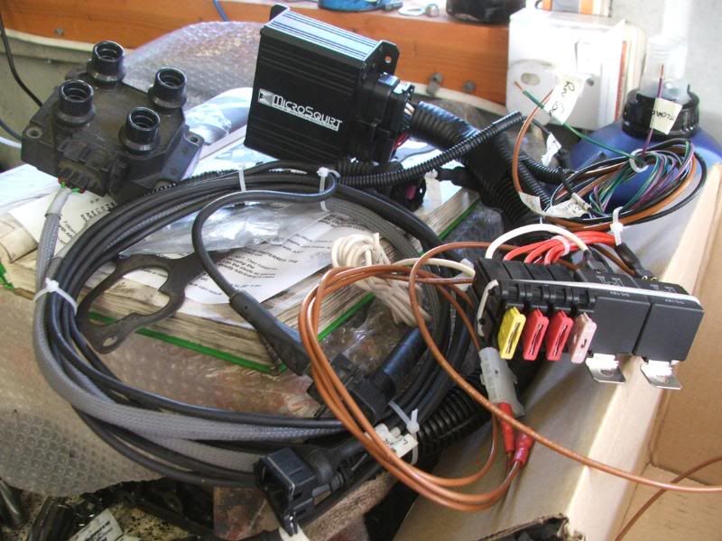

i'm very new to Microsquirt, having bought the unit back in sept 08 for my prject only just got round to installing it on my VW GOLF GTI MK1 , running a 2.1L 16V Engine c/w 45mm Jenvey DTH Throttle bodies. :D
I've loaded all the programs onto the pc and purchased the USB Adaptor from DIYAUTOTUNE :mrgreen:
The first and major problem i am having is the laptop will not connect to the Microsquirt ECU.
The comms port is showing port 18 connected and correct speed etc, ecu powered up on 12v dc supply but still will not connect :(
Is this a common problem :?:
Microsquirt ECU & Loom
