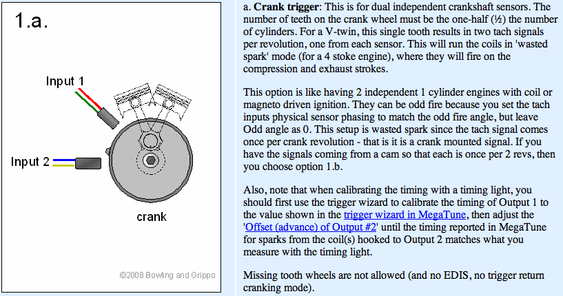

If it's popping and banging,, your spark is at the wrong time, but you need to identify which one. Favourite would be to disconnect a plug and try and get it running on one cylinder, although I assume you have the following set up with just one tooth on your wheel/flywheel, if you don't that will explain some of your problems.
Manual page screenshot
(110.7 KiB) Not downloaded yet
I think 800vtwin or grippo will be able to add some specifics. 8)

Grippo, I did as you suggested in the png, used the wizard and then messed with the advance for IGN2. Didn't work. I have two marks on the crankshaft flywheel, one in yellow at 27.5 BTDC of cylinder 1 and a white mark at 27.5 BTDC for cylinder 2. With 27.5 as base timing, I tried various numbers in IGN2 advance, 0.0,27.5,-27.5,80.0,-80.0 and only see the yellow mark on the flywheel with the timing light for cylinder 2. As a WAG I tried 350 degrees and the white mark showed up, but the engine did not run well. Attached is the msq file with 350 degrees.

SunsetMoto wrote:The stock CX ignition operates in an unusual way by fact of it having two sets of pick ups for each cylinder - one for static timing and one for dynamic timing, I presume you are only using one pick-up for each ignition event.
This is like an XT600 IIRC, and I think this will be the problem. If you remove one lug, it should be OK and wire the VR sensors as per the schematics, it should work. I think a few folks have used the Logic Level Outputs to trigger the CDI boxes on other bikes, again IIRC.
Re: Need Help with 2 cylinder CX500 timing
You have specified Dual Tach inputs which means the odd-fire angle is obtained by the placement of the sensors (80 deg apart instead of 180 deg). So you need to set the #2 offset (odd angle) to 0 not 350 deg. Secondly, in dual spark mode, trigger offset needs to be negative. What this means is that you have to go past tdc the first time (so the tach pulse occurs ATDC hence trigger offset is negative) and then it will predict the next tach pulse and start dwelling and prepare to spark at some advance before the next tach pulse for that cylinder arrives.

Run it in wasted spark fashion and fire each cylinder every revolution. Unless the pick-up wheel is spinning at cam speed, I'm pretty sure that is how Honda did things too.
The timing on your setup should take care of itself by the position of the dual sensors. We need to start from basics. How many teeth are on the crank flywheel - by that I mean teeth that are sensed by the dual sensors, not starter teeth ?
If there is one tooth, as there should be, then each sensor becomes an independent cylinder, so with 0 trigger offset, and in cranking with injectors disconnected, and table advance in the cranking area set to 0, or use trigger rise mode, you should fire at 27.5 deg btdc on each cylinder if the sensors are positioned in this way. That is, it should fire immediately as soon as the VR input is sensed, and both sparks should occur at the same relative offset to TDC for each cylinder. It doesn't matter what the cylinder offsets are as long as the sensors are offset the same way. If they aren't then we have to fool with odd angle, but only odd angle to get both to spark at 27.5 deg btdc, then you can fool with trigger offset to get it to spark at 0 deg. Then you can put in a table advance without trigger rise and it should all work.
