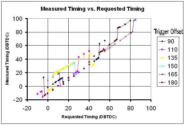

I've got my uS running on my bench for testing purposes and noticed that occasonally the timing would jump around. I decided to investigate this a little bit and hooked up a scope to the crank signal and the timing output from the uS. What I found was that depending on the trigger offset, timing can jump up or down 20 degrees depending on the timing that is being requested. I've attached a picture of the results. Fortunately I wanted to use a 135* trigger offset for my setup, so the timing shouldn't jump around as long as I command a timing value between 5 to 40 DBTDC. Had I chosen my crank trigger to need a trigger offset of another value (110* or 150* for example) and I would have had timing jumping around quite a bit.
Even without timing jumping around and using my 135* trigger offset, the measured timing value is consistantly off by +10 to +12 degrees. Obviously I could shift my trigger offset by about 10 or 12 degrees to address this, but it seems odd to me. Is there something I've done wrong with my msq setup that is causing this?

I am using an optical sensor that generates a square wave Verified with the scope, so I don't think it is the polarity issue. The data was collected at a constant speed (1450 RPM), so the VR delay might explain the +10 error, but it doesn't explain the sudden shift in timing accuracy as requested timing changes.... at least I'm not sure how.
Something that I find very coincidental is that the span of timing values between the jump up and jump down is ~36 degrees, which is the spacing between trigger events of my 10-1 wheel. If the tooth used to find the "last individual tooth interval" has a slightly different shape or dt between teeth compared to the spark tooth, maybe this could happen? http://www.useasydocs.com/details/crankwheel.htm I'm not familiar with the alpha, beta, gama predictor routine, and I think I have my software set to last interval or something similar.

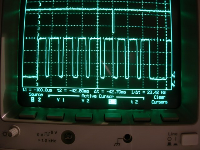

Sounds like it must be a problem with my setup then. I have been scratching my head for a while now without any ideas . I've attached two pictures of my scope with the same msq that you tested. The first picture is 5 degrees timing advance and the second picture is 4 degrees. You can clearly see from the picture that the timing signal jumps a whole tooth. I can't think of any reasons it would do this.
The two traces in the pictures are the crank wheel input to the microsquirt (not the ecu pin) and the spark output. The crank trigger is set to "falling edge" to line up with the crank wheel signal's rising edge.
Any suggestions or thoughts why the timing seems to jump so much with only one degree change in requested timing advance?

When you say triggering, I assume you mean the trigger on the scope? In the pictures above I was using the tach output signal to trigger the data capture on the scope. I have also used the spark output, with similar results showing that it will jump ahead a tooth.
As a side note, I've also used an LED connected to the spark output to visually show where the spark happens relative to the crank wheel (very much like a timing light). It also shows a sudden jump in timing, so I don't think it is a matter of the scope setup.
