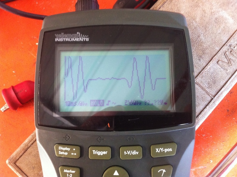

Im using a microsquirt v3 on a 97ish Husqy TC-610 and I'm having trouble getting an ignition input signal
Im using the factory ign pick up that is integrated into the stator that would normally trigger the CDI unit.
Im not sure if the microsquirt can interpret the signal correctly?
Can anyone confirm that it will or wont?
ign pickup scope capture
(192.86 KiB) Not downloaded yet

i dug a little more deeper and the stock pickup is a coil wound around a soft iron structure, there is no magnet in it, hence why the signal is odd looking., and there are def two magnets side by side inside the rotor.
looks like i will need to mount a trigger wheel and pick up somewhere on the crank.
