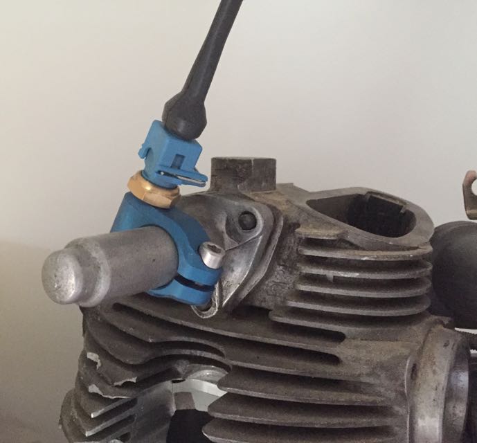

It's best to use head temperature, as oil temperature doesn't follow head temperature very well. Air cooled engines can warm up quite quick, and my air cooled Panhard engines, actually run cooler at certain revs, because of the airflow characteristics over the oil sump.
I made an adapter, that clamped to a part of the head (exposed torsion bar valve return covers) and used a standard coolant or oil temperature sensor off a Land Rover. I only chose this one, because it was cheap, and the connector was readily available. If you use a Bosch one, you can get all the resistance/temperature info for calibrating on the net, but most top out at just under 150ºC, a few can run slightly hotter, but in all fairness, you're not really interested in exact temps at this end for WUE.
(47.64 KiB) Not downloaded yet
PS Link to 130ºC sensor http://www.boschmotorsport.com/media/ca ... 739pdf.pdf
